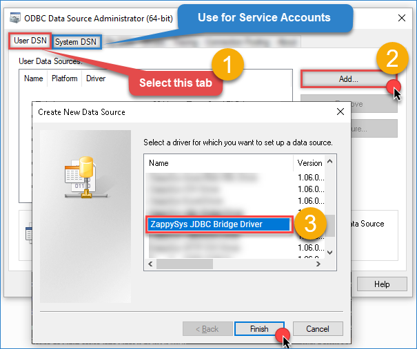

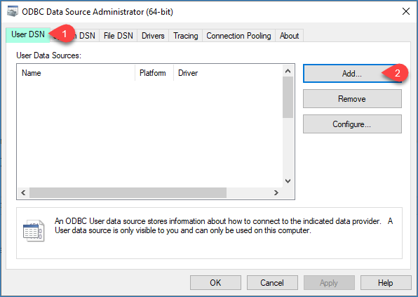

  1. Open ODBC Data Sources by typing “ODBC” in the Windows search box and launching ODBC Data Sources (64-bit).
  2. To allow access for SSIS, go to System DSN (recommended for SQL Server Integration Services) and click Add.
  3. From the driver list, select ZappySys JDBC Bridge Driver, then click Continue.

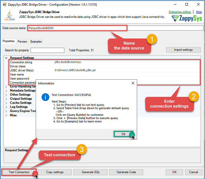

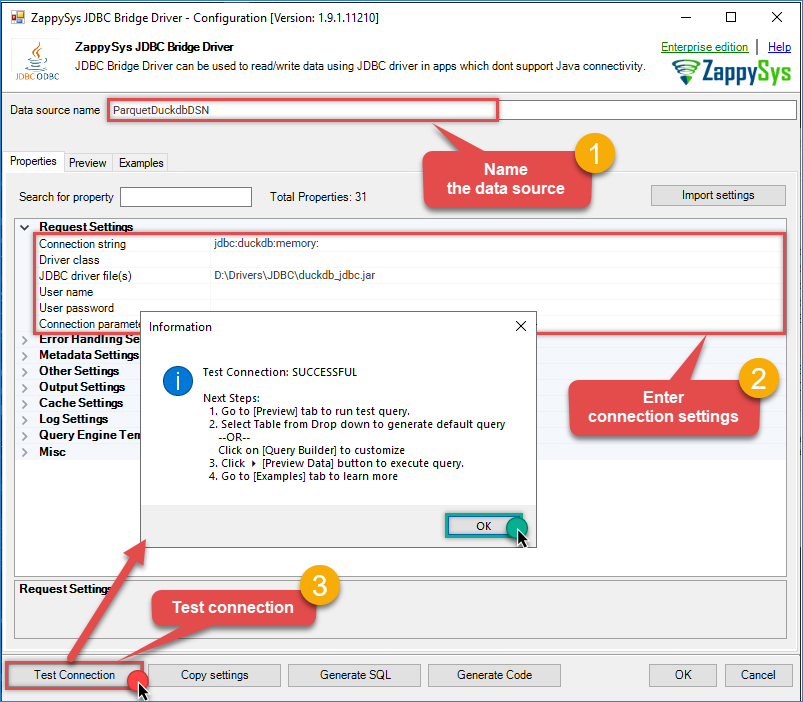

  1. Enter the connection settings and configure the required parameters.
  2. Use the following values:
    • Connection string:
      jdbc:duckdb:memory:
    • JDBC driver file(s):
      D:\Drivers\JDBC\duckdb_jdbc.jar
  3. Click Test Connection to validate the configuration.

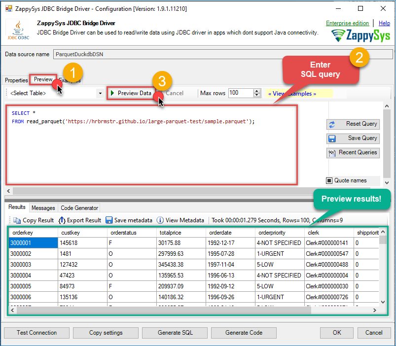

  4. Go to the Preview tab and run a sample query to confirm access to the Parquet file. For more SQL examples, see the JDBC Bridge documentation.
SELECT *
FROM read_parquet('https://hrbrmstr.github.io/large-parquet-test/sample.parquet');
  1. Verify that data is returned successfully, then click OK to save the configuration.

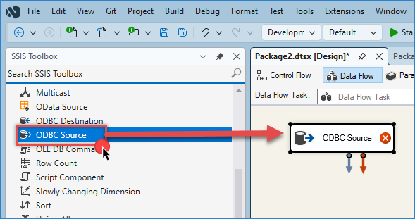

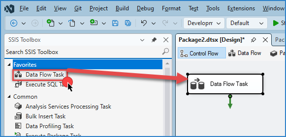

  3. Drag and drop a Data Flow Task from the SSIS Toolbox onto the Control Flow surface and double-click it.

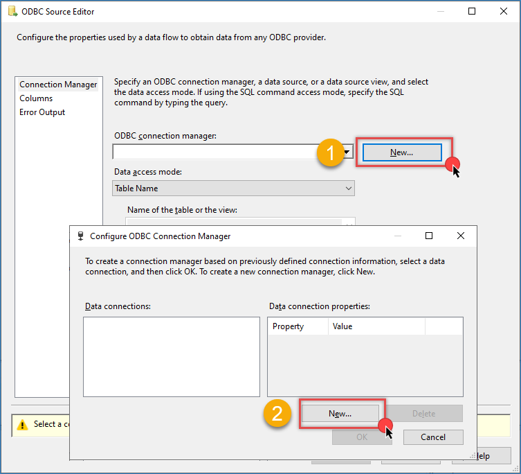

  4. Inside the Data Flow, drag and drop an ODBC Source component.
  5. Double-click the ODBC Source to configure it.

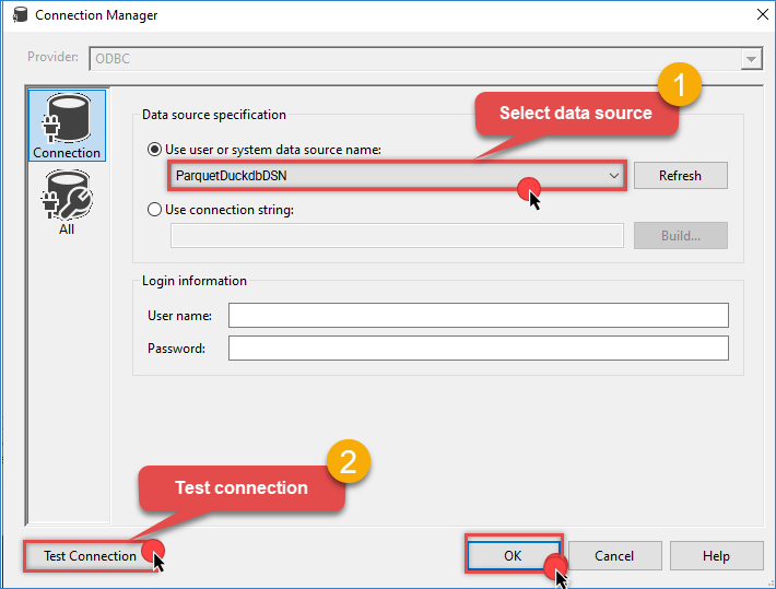

  6. Click New to open the Configure ODBC Connection Manager window, then click New again to create a new ODBC connection.
  7. Select the DuckDB ODBC data source you created earlier, click Test Connection, then click OK to finish the configuration.

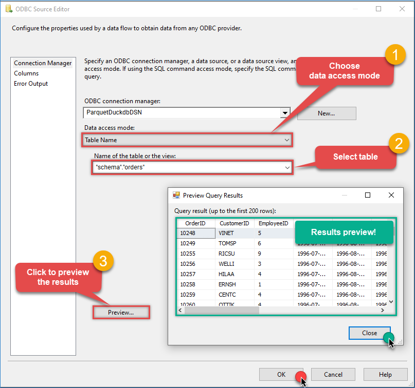

  8. Choose the Data access mode (Table name or SQL command).
    • Select a table if available, or
    • Enter a SQL query (for example, a read_parquet query).
      Click Preview to validate the results, then click OK.
