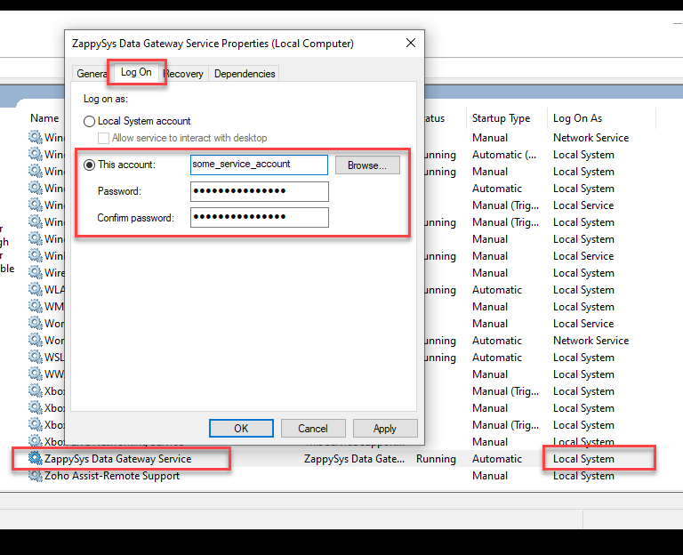

2. Run the Data Gateway Service Under a Dedicated Account
By default, the ZappySys Data Gateway runs under the Local System account. This often causes issues because Local System doesn’t have the same network permissions as your logged-in user.
Best Practice:
  • Create a dedicated service account (e.g., svc_zappygw).
  • Assign it as the Log On As user for the Data Gateway Windows service.
  • Avoid using employee accounts — if the employee leaves and the account is disabled, your Gateway will stop working.
