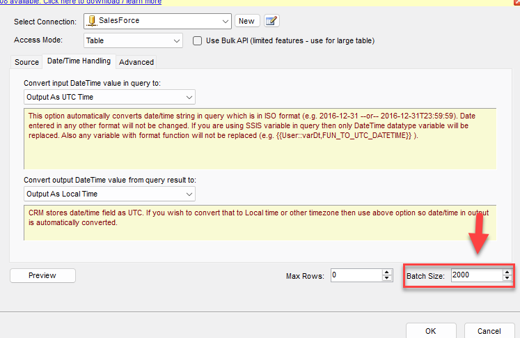

1. Reduce Batch Size
If queryMore is failing, it’s likely struggling with the size of the data chunks being passed.
  • In your Salesforce Source component, look for the Batch Size property (the default is often 2000).
  • Lower this to 500 or 1000. Smaller batches are less likely to trigger a timeout or a 503 under load.

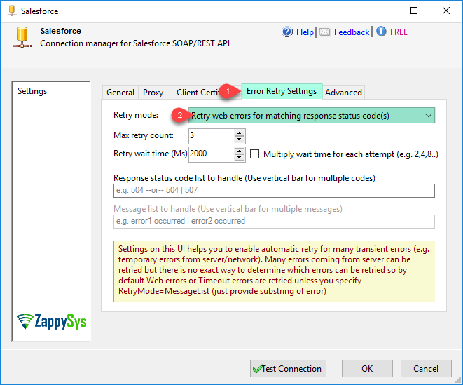

2. Implement or Increase Retries
Since 503 errors are often “blips,” the most effective solution is a retry strategy.
  • Check your ZappySys Salesforce Connection settings. Look for Retry Settings.
  • Set the Retry Count to 3 or 5.
  • Set a Retry Wait (back-off) of at least 5-10 seconds. This gives the Salesforce instance a moment to breathe before you hit it again.
