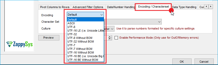

You can easily resolve encoding issues by specifying the correct encoding in the JSON Source component. Here’s how to do it:
  1. Open the JSON Source component in your SSIS package.
  2. Navigate to the Encoding/Character Set tab.
  3. From the dropdown, select the appropriate encoding for your file. In this case, select UTF-16 (or any other encoding you need based on your file’s actual encoding).
  4. Click OK to save your configuration.
Using this setting, the JSON Source should now correctly read the JSON file with the correct encoding.
