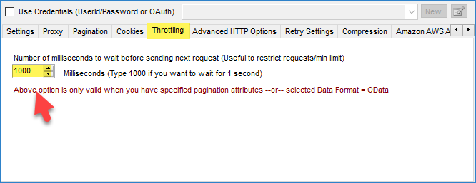

Step 2: Enable Throttling
If you are using the ZappySys JSON Source or XML Source for paginated API calls, enable Throttling.
This feature instructs the component to wait between consecutive API calls, preventing you from exceeding the provider’s rate limit.
  1. Open the source component.
  2. Click the Throttling tab.
  3. Set the Number of milliseconds to wait before sending the next request.

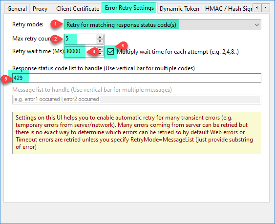

Step 3: Enable auto-retry in the OAuth/HTTP connection manager
If your API occasionally returns 429 errors due to temporary spikes, enable Auto-Retry Handling in your HTTP or OAuth Connection.
This option allows the component to automatically retry failed requests after a short delay, rather than failing immediately.
  1. Open your OAuth Connection or HTTP Connection.
  2. Go to the Error Retry Settings tab.
  3. Enter the error code 429, set the Max Try Count, and define the Retry Wait Time.
