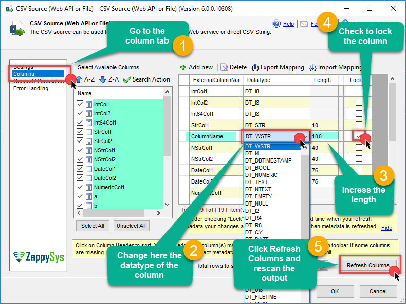

Method 1: Increase length/datatype in source component
  1. In Data Flow, double-click the source component that failed.
  2. Go to the Columns tab.
  3. Increase column length and/or change data type for affected columns (for example, ColumnName).
  4. After adjusting metadata, enable Lock for columns you changed so future refresh does not undo your manual settings.
  5. Optional: Click Refresh Columns and rescan using a wider Metadata Scan Mode.
