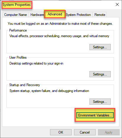

Go to:
System Properties > Advanced > Environment Variables

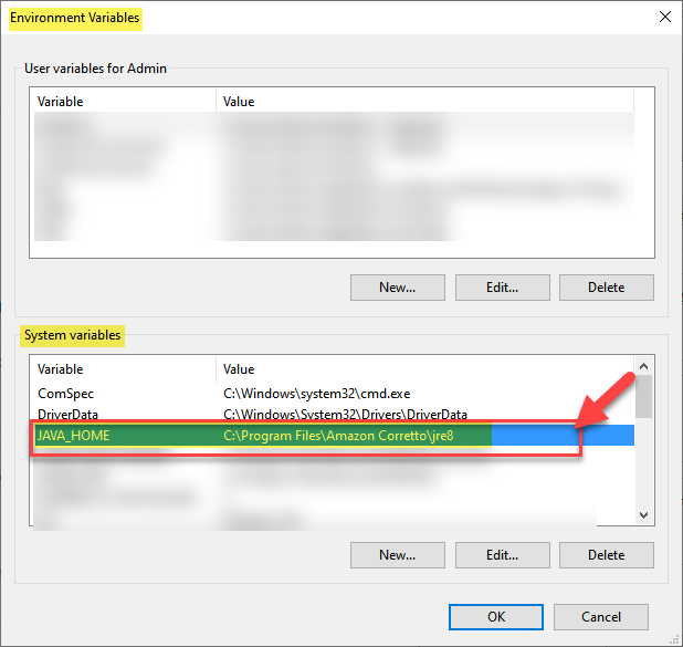

Under System Variables, please check if a variable named
JAVA_HOMEexists. If it does, edit it to point to your installed Java folder path.
If it doesn’t exist, click ‘New’ under System Variables and create it by adding the correct path to your Java installation.:- Variable name:
JAVA_HOME - Value: Path to your JDK/JRE, e.g.,
C:\Program Files\Amazon Corretto\jdk1.8.0_xx - Variable name:
