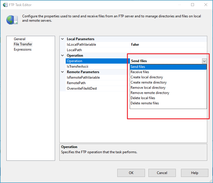

The FTP Task in SSIS allows you to transfer files over the File Transfer Protocol (FTP). While this is suitable for simple file transfers, FTP is unencrypted, making it vulnerable to eavesdropping. For environments requiring high security, FTP is not recommended.
The FTP Task supports the following operations:
- Send Files
- Receive Files
- Create Files
- Remove Files

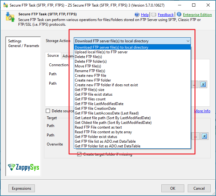

The SFTP Task in SSIS uses the SSH File Transfer Protocol (SFTP), which encrypts the entire communication, ensuring secure file transfers. If your organization handles sensitive information or operates in a regulated environment, SFTP is the preferred choice.
The SFTP Task supports all the actions available in the FTP Task, with the addition of:
- Get File Size
- Get File Status
- Get Creation/Modification Date
- Get a List of Files/Folders
- And more…

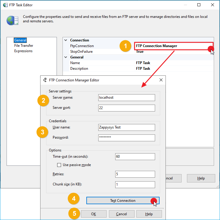

Under the FTP Connection Manager, click New Connection to configure the FTP server connection.
Enter the server name, port, and login credentials.
Test the connection and click OK to save the configuration.

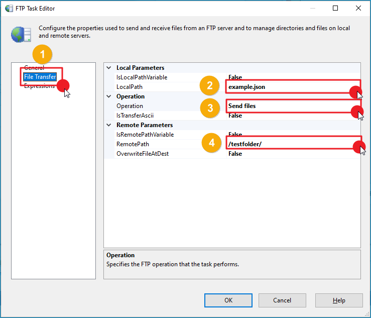

Click on the File Transfer tab.
Under the Operation section, choose the Send files option to upload a file to the FTP server.
In the Source File field, select the file to upload from the local machine.
In the Destination Folder field, specify the target directory on the FTP server.
Save the configuration and click OK.
Run the package, and the file will be uploaded to the FTP server.

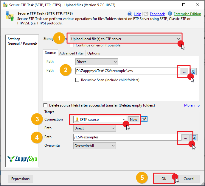

Drag and drop the SFTP Task into the Control Flow.
Open the task.
In the Action section, select Upload local file(s) to FTP server.
In the Source Path field, browse and select the file to upload.
Under the SFTP Connection Manager, click New Connection to configure the SFTP connection.
Enter the server’s host, port, and login credentials. You can review other settings in the tabs if further configuration is needed.
In the Destination Folder field, specify the target folder on the SFTP server.
Optionally, check the Overwrite file if it exists option, depending on your requirements.
Click OK to save the configuration.
Run the package, and the file will be securely uploaded to the SFTP server.

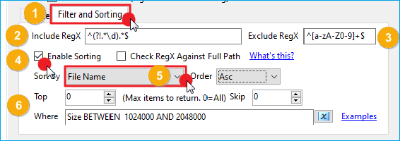

Under the Filter and Sorting tab, you can:
- Apply Regex patterns to include/exclude files.
- Enable Sorting by name, size, or date.
- Use Top to limit the number of files or Skip to bypass the first N files.
- Use the Where field to filter files by size, date, extension, etc. For more information, click Examples.
