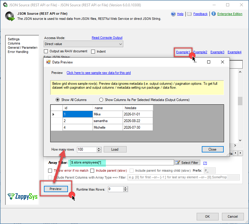

Drag and drop a source component; in this example, we’ll use the JSON Source.
Enter a valid source table. We’ll use example 1 from the component, with the following data. We’ll update the first 2 rows and insert the last user into the database.

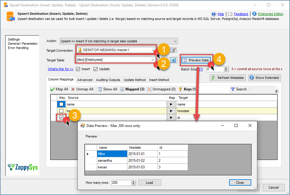

Configure the destination component: create or select the connection and the target table.
Check the primary key(s).
Preview the data from the database to confirm it looks correct.
Click OK to save the configuration.

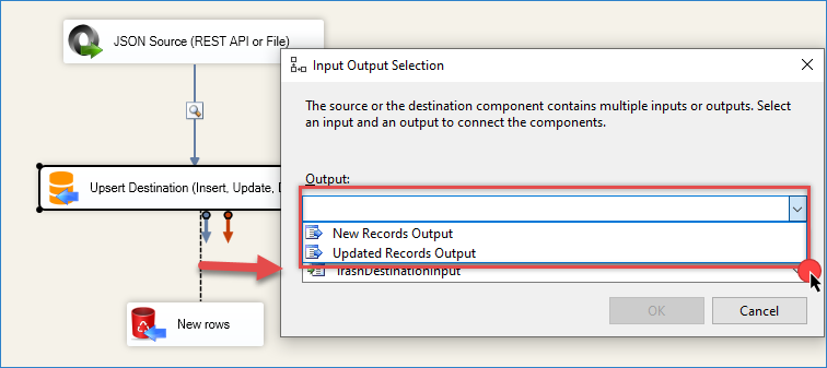

Drag a connector from the Upsert Destination to the destination component where you want to capture the inserted and updated rows (e.g. a Trash Destination for testing).
Since the Upsert Destination has multiple outputs, the Input Output Selection dialog appears. In the Output dropdown, select New Records Output.
Click OK. This output will now carry only the rows that were inserted.

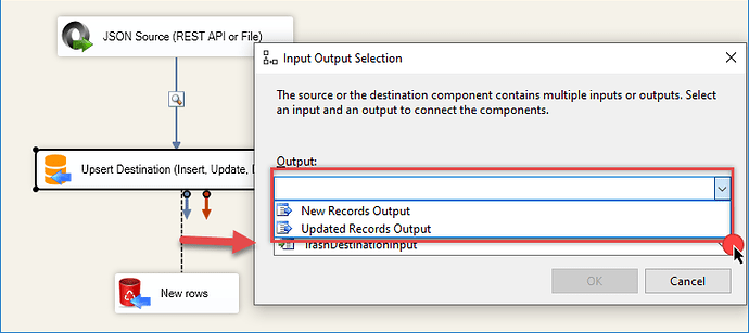

Repeat the process: drag another connector from the Upsert Destination to a second destination component, and this time select Updated Records Output in the dialog.
Click OK. This second output will carry only the rows that were updated.

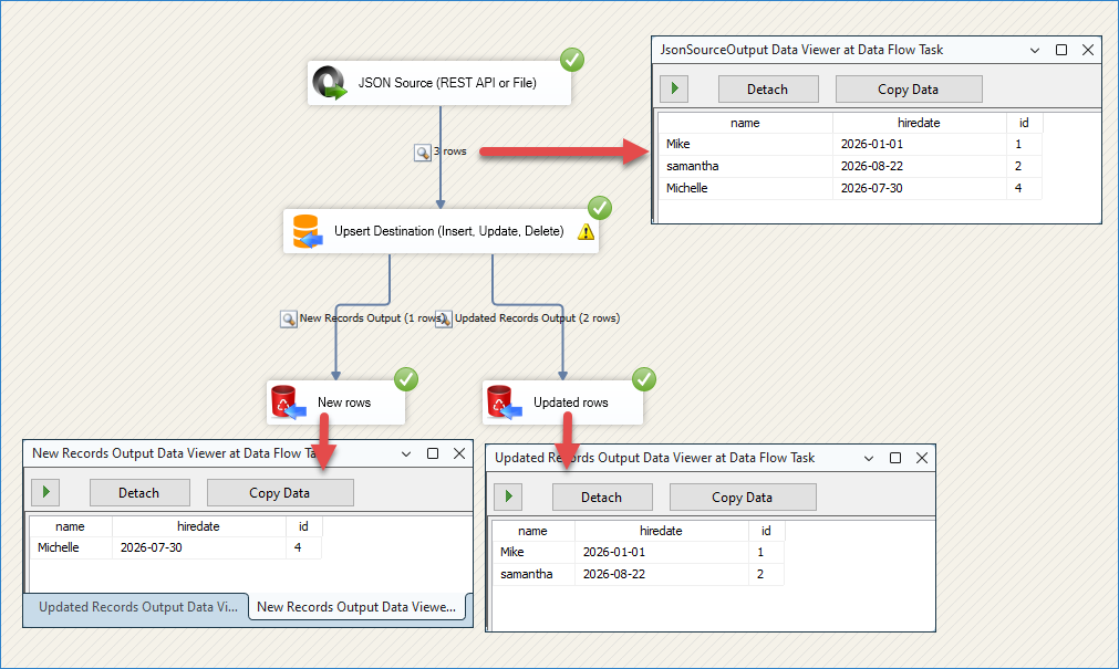

Run the package. Each destination will receive only the rows matching its assigned operation type.
The New Records Output and Updated Records Output on the Upsert Destination component let you capture inserted and updated rows separately, without adding extra lookup or comparison logic to your Data Flow. This makes it straightforward to log, audit, or route insert vs. update operations independently.
