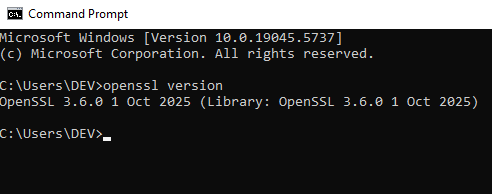

After installation, verify:
openssl version

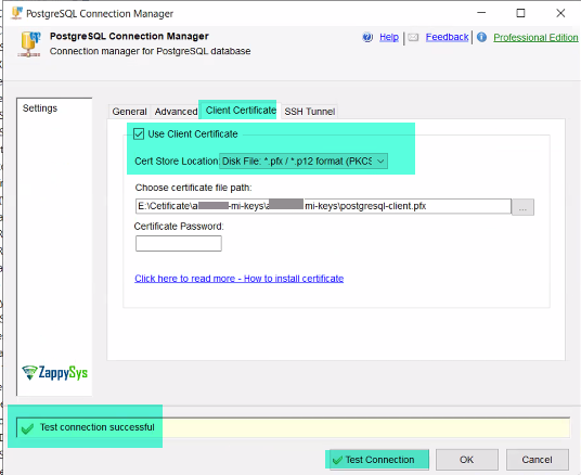

Step 4 — Configure ZappySys PostgreSQL Connection Manager
  1. Open your SSIS package
  2. Add or edit PostgreSQL Connection Manager
  3. Enable SSL / Certificate Based Authentication
  4. Configure:
  • Certificate File Path → postgresql-client.pfx
  • Certificate Password → Password used during .pfx creation
  1. Leave PEM-related fields empty
  2. Click Test Connection
:white_check_mark: Connection should now succeed.
