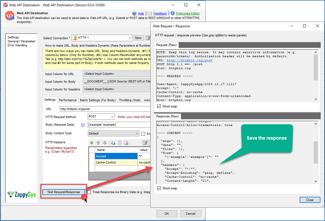

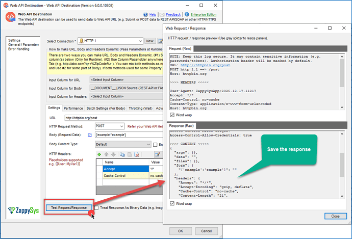

In the Web API Destination editor, get a sample response using Test Request/Response, or check your API’s documentation for a sample response. Make sure the response body is available as an output column, for example,
response_body.

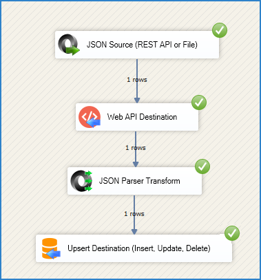

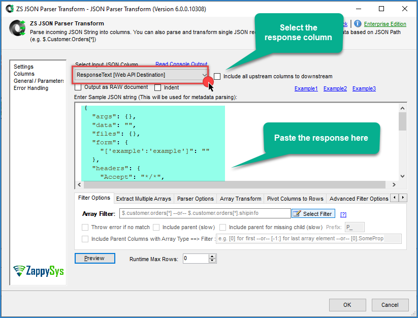

Drag ZappySys JSON Parser task (or XML Parser Task, depending on your API’s response format) and connect it after Web API Destination. Select the raw response column,
ResponseText, as the input, and paste the sample response you found in the previous step. Set the filter/path if needed to reach the fields you want, and use Preview to confirm the output columns look correct.

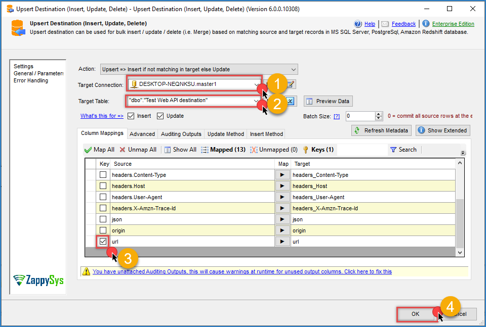

Drag ZappySys Upsert Destination and connect it after the parser. Configure the connection, select your target table, set the key column(s) to match on, and map the remaining fields. Click OK to save.
Run the package and check the result in your database.
