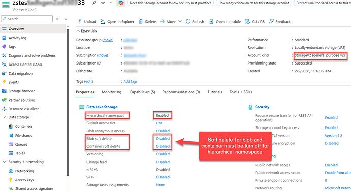

Before connecting from SSIS, confirm that your Azure Storage Account is ADLS Gen2–enabled, which means it supports a hierarchical namespace.

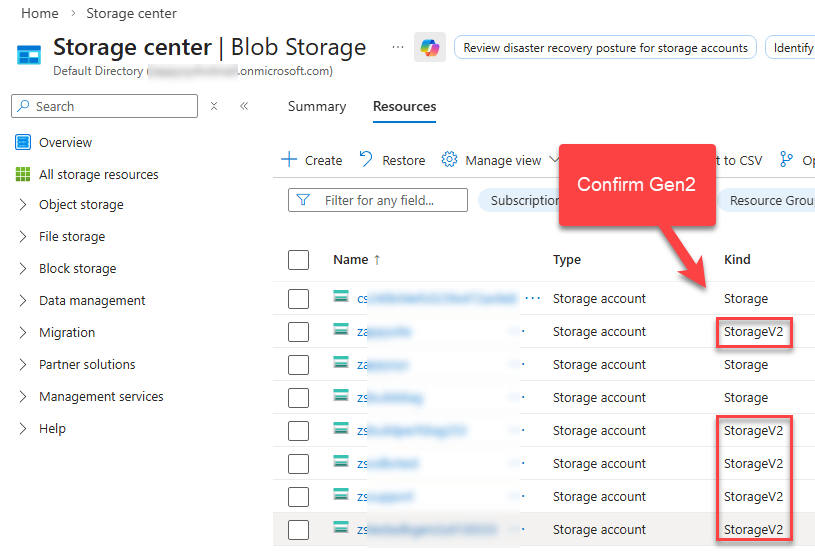

Check the Storage Account Type. Go to Azure Portal → Storage Accounts and verify that your account is ADLS v2 (Gen2).
Open the storage account

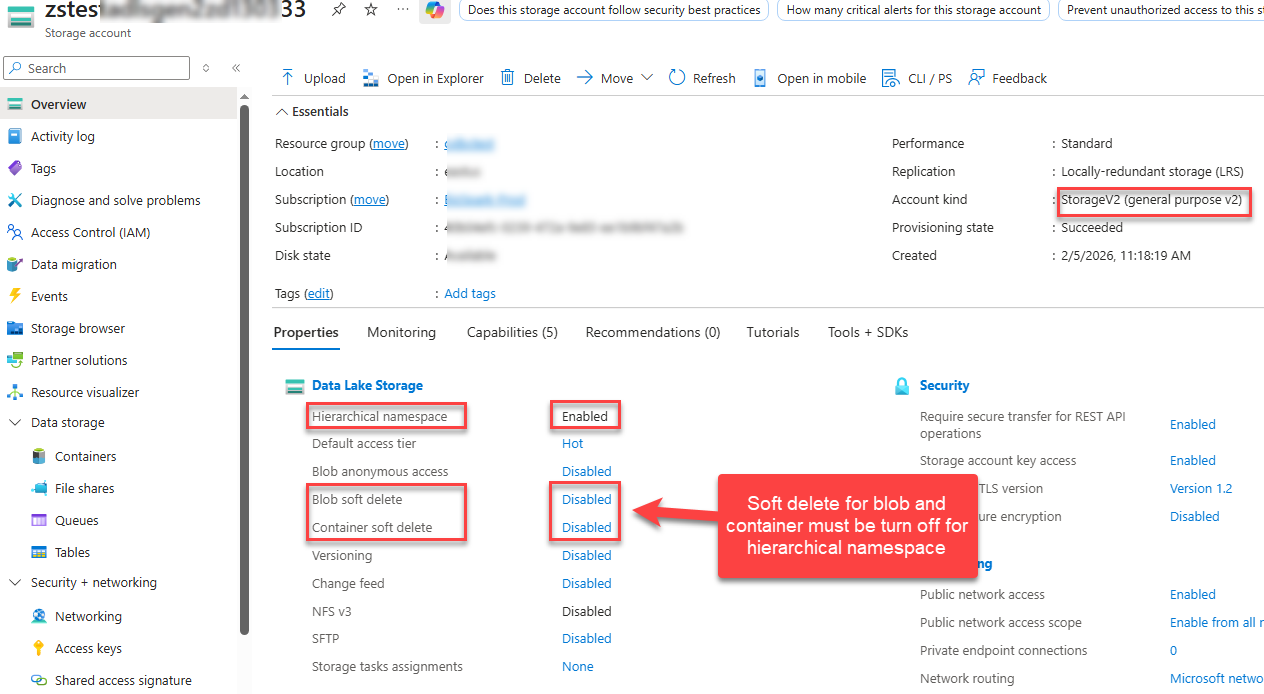

Locate Hierarchical namespace
Ensure it is set to Enabled
If hierarchical namespace is not enabled, click Enable
During the wizard, Azure may require Soft Delete to be turned off
Disable both soft delete options if prompted
Important
Enabling hierarchical namespace is a one-way operation. Once enabled, the storage account cannot be reverted to a flat namespace.

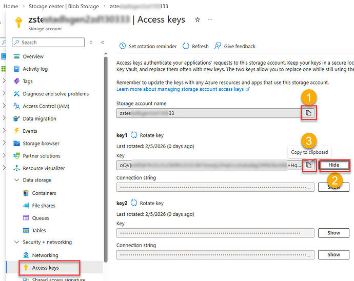

Option A: Connect Using Storage Account Access Key. This is the simplest method and works well for internal or controlled environments.

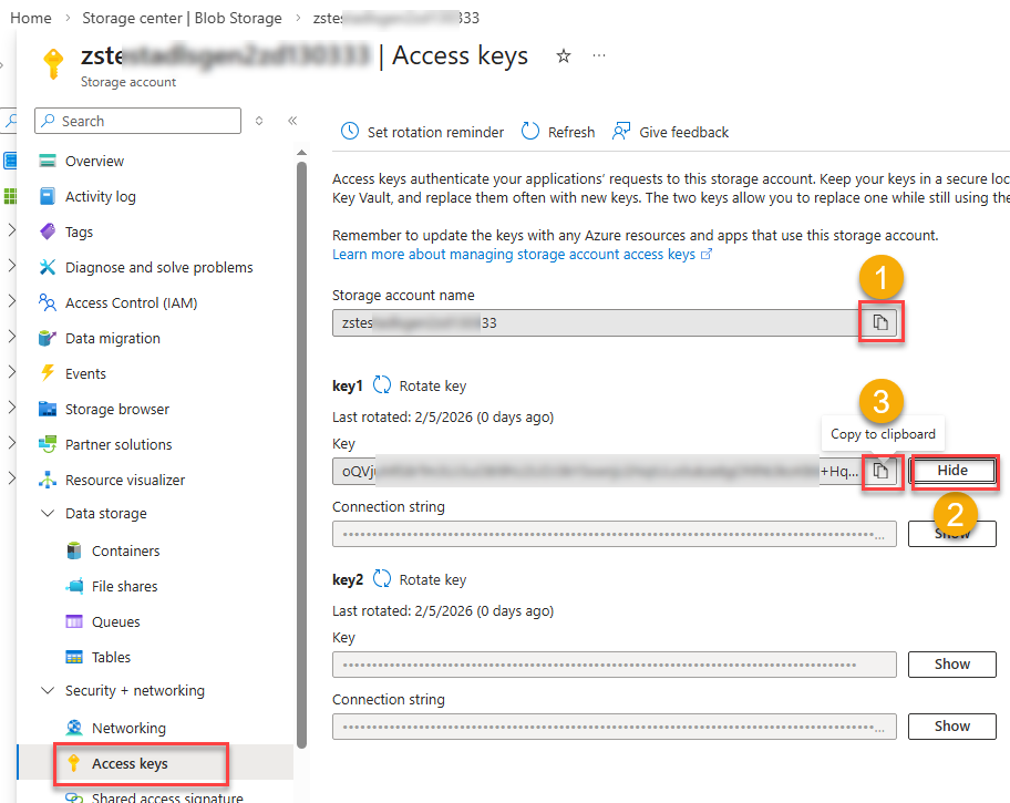

Obtain the Access Key.
Go to your Storage Account.
Navigate to Access keys.
Copy Key1 or Key2.

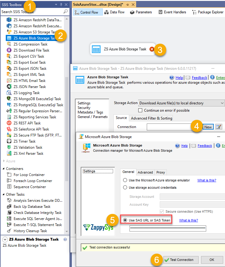

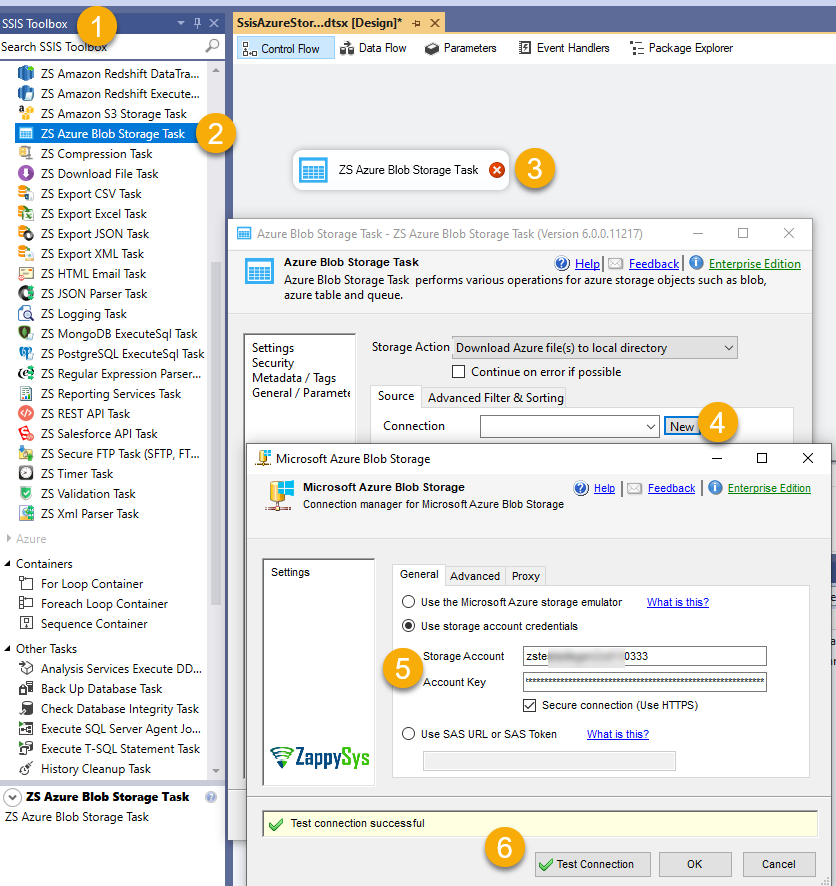

Create or open an SSIS project in Visual Studio and add the ZappySys Azure Storage Task.
Create a new connection and choose Access Key authentication.
Enter the Storage Account Name and Access Key and test the connection.

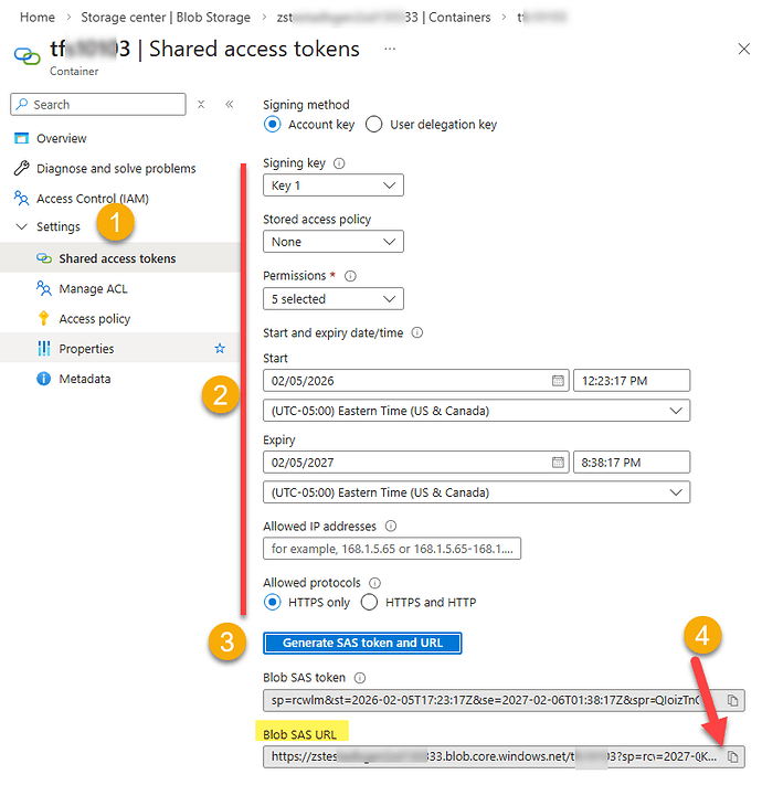

Option B: Connect Using SAS Token (Recommended for Least-Privilege Access). SAS tokens are ideal when you want restricted, time-bound, or container-level access.

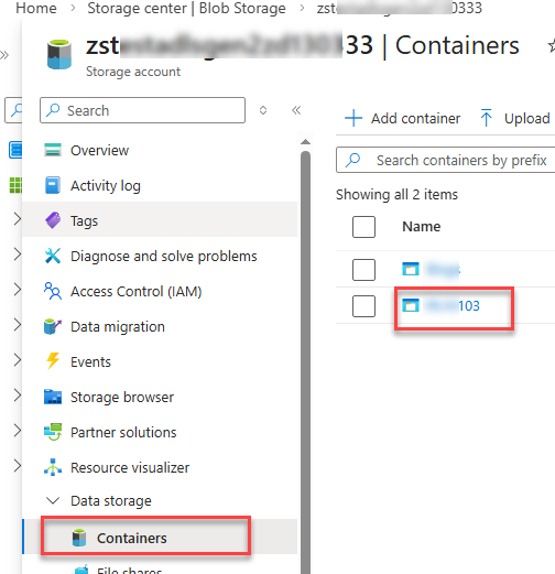

Navigate to the Target Container
Open Storage Account → Containers.
Select the container you want to grant access to.

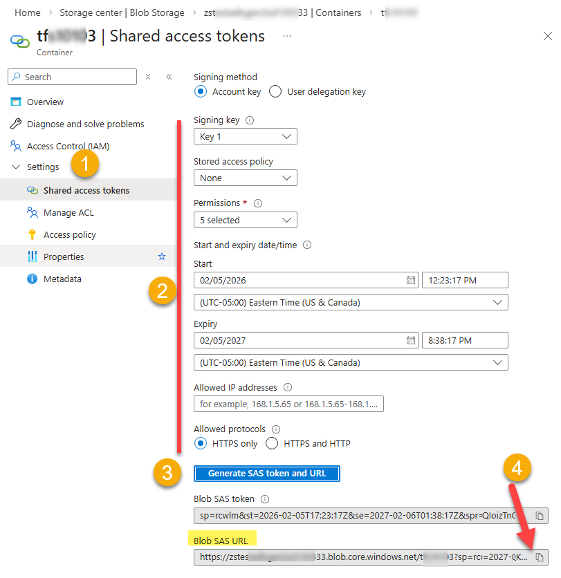

Click Generate SAS to generate a Container-Level SAS Token.
Select required permissions (Read / Write / List / Delete).
Set expiration date.
Generate and copy the SAS URL.
Recommended: Use SAS URL for quicker and more reliable configuration. While SAS Token authentication is still supported, Copy SAS URL is easier and more user-friendly because it already includes the container path. When you paste the SAS URL into the Connection UI, the container name is automatically detected, eliminating the need to enter it as a separate step manually.
- Go to our Microsoft Azure Blob connection and use the SAS Token in SSIS
- Choose SAS Token authentication in the Azure Storage Task and provide the SAS Token or URL.
- Test the connection and click OK to save the configuration.

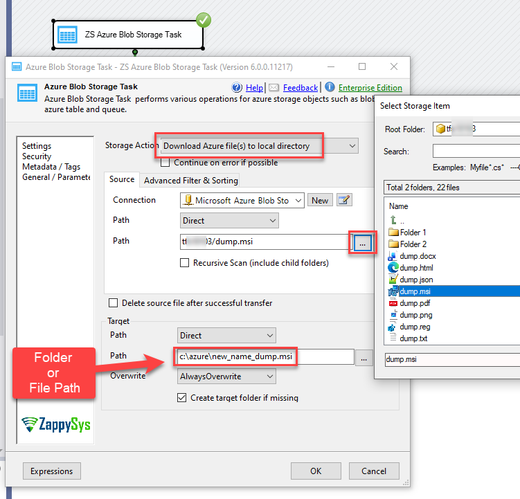

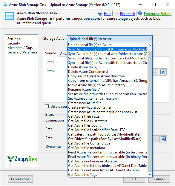

Download Files from Azure ADLS Gen2 in SSIS
- Inside the ZappySys Azure Storage Task, select the connection created in the previous step.
- Use the option DownloadAzure File(s) to local directory.
- Select the Parquet or CSV files you want to download. You can pull files from date-partitioned folders and use dynamically built paths with SSIS variables.

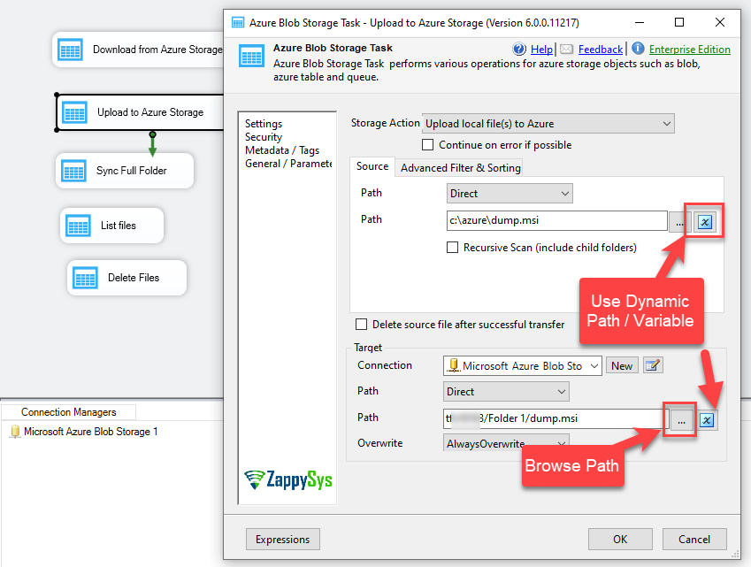

Upload Files to Azure ADLS Gen2 in SSIS

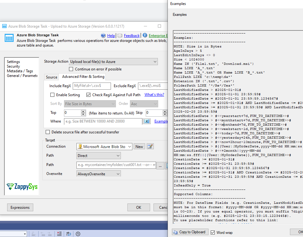

- Change the Storage Action to Upload local file(s) to Azure.
- Upload single files or entire folders.
- Choose between Overwrite or skip existing files.
- Use the ZappySys placeholder engine to build source and destination paths dynamically
Other Azure Storage File Operations
The Azure Storage Task supports many additional operations:
- Sync folders
- Create containers or directories
- Delete files or folders
- List files recursively

Most operations support advanced filtering and sorting options. These options are available under the Advanced Filter and Sorting tab:
- Filter by file name
- Filter by size
- Filter by modified date
- Sort ascending or descending
- Limit the number of files processed
