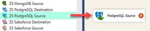

- Double click on the Data Flow task to see Data Flow designer surface.
- Here, In Visual Studio, drag and drop the PostgreSQL Source in the design surface.
- Double-click to configure, Click New connection, and setup that

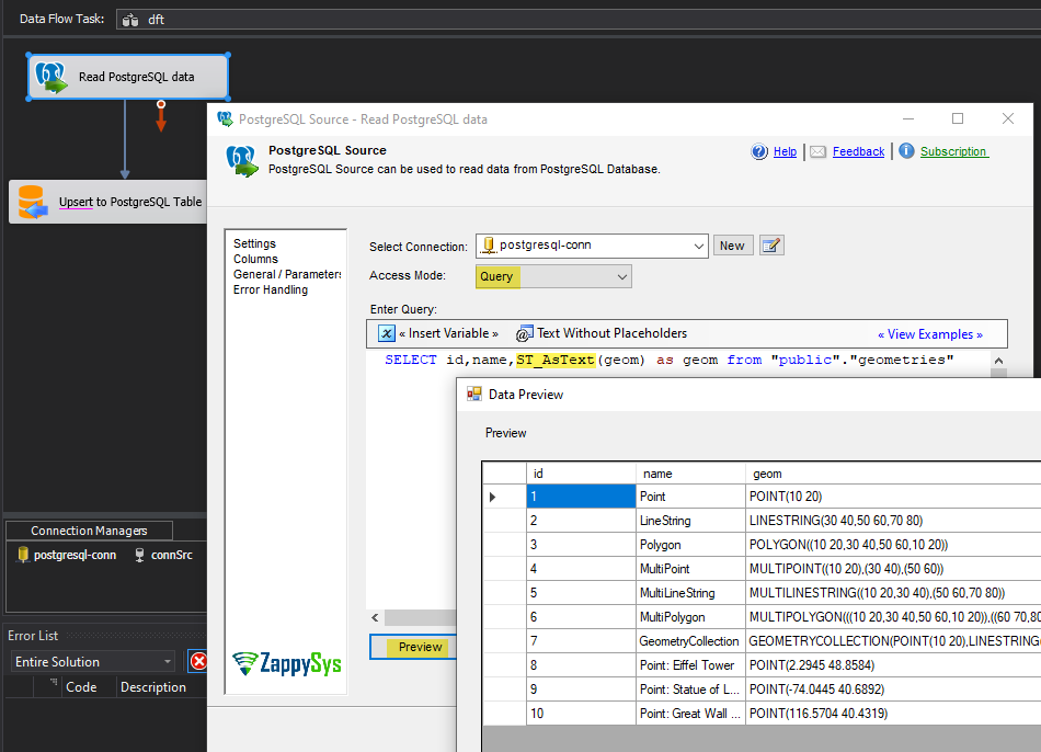

- On Source UI, change to Query mode and type SQL as shown below. Notice we have converted Geometry column into WKT (Well-Known Text) using ST_AsText function. This will allow the SSIS engine to output data as a string rather than a binary type. Without this, you will get an error.
SELECT id,name,ST_AsText(geom) as geom from "public"."geometries"

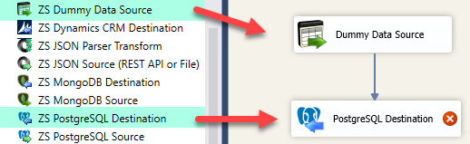

- Drag and Drop SSIS Data Flow Task from SSIS Toolbox.
- Here, In Visual Studio, drag and drop the DummyData Source and ZS PostgreSQL Destination in the design surface and join the components with the blue arrow.

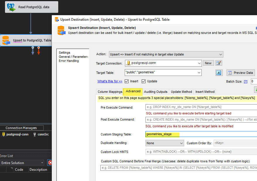

How to Upsert Geometry Type in SSIS (INSERT or UPDATE or DELETE)
Now lets look at how to Upsert data into PostgreSQL Table with Geometry Type. If you try to write data into the Geometry column, it may fail unless you use the staging setup as below (use TEXT type).
To write data to target table with Geometry Type you have to prepare a staging table with the same structure as target but use Text type rather than Geometry.
Create a Stage Table to handle Geometry Type
Here is how to create a staging table with the same structure as the target.
Notice we used LIMIT 0 to create an empty structure.
select * into geometries_stage from geometries limit 0
Confirm Stage Table is created.

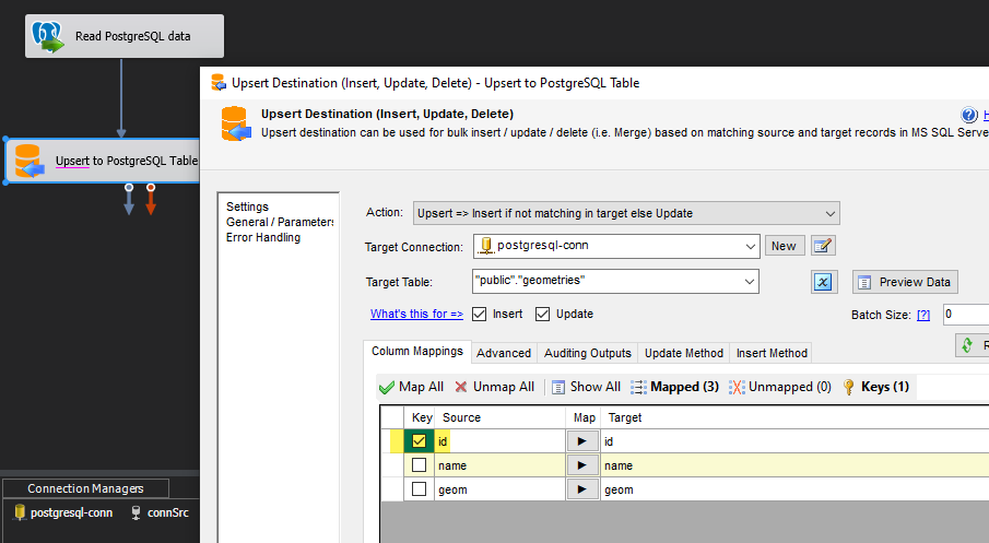

Configure SSIS Upsert Destination
Here is how you can configure Upsert Destination.
