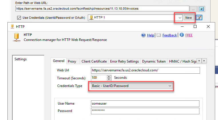

Step 1: Create a New HTTP Connection
- In your SSIS project, right-click on Connection Managers and choose New ZappySys HTTP Connection.
- In the URL box, enter your Oracle Fusion REST API base URL
Syntax:https://<your-domain>.fa.<region>.oraclecloud.com
Example:https://servername.fa.us2.oraclecloud.com - Go to the Authentication tab:
- Select Basic Authentication
- Enter your Username and Password
For more information on HTTP Connection, check this article

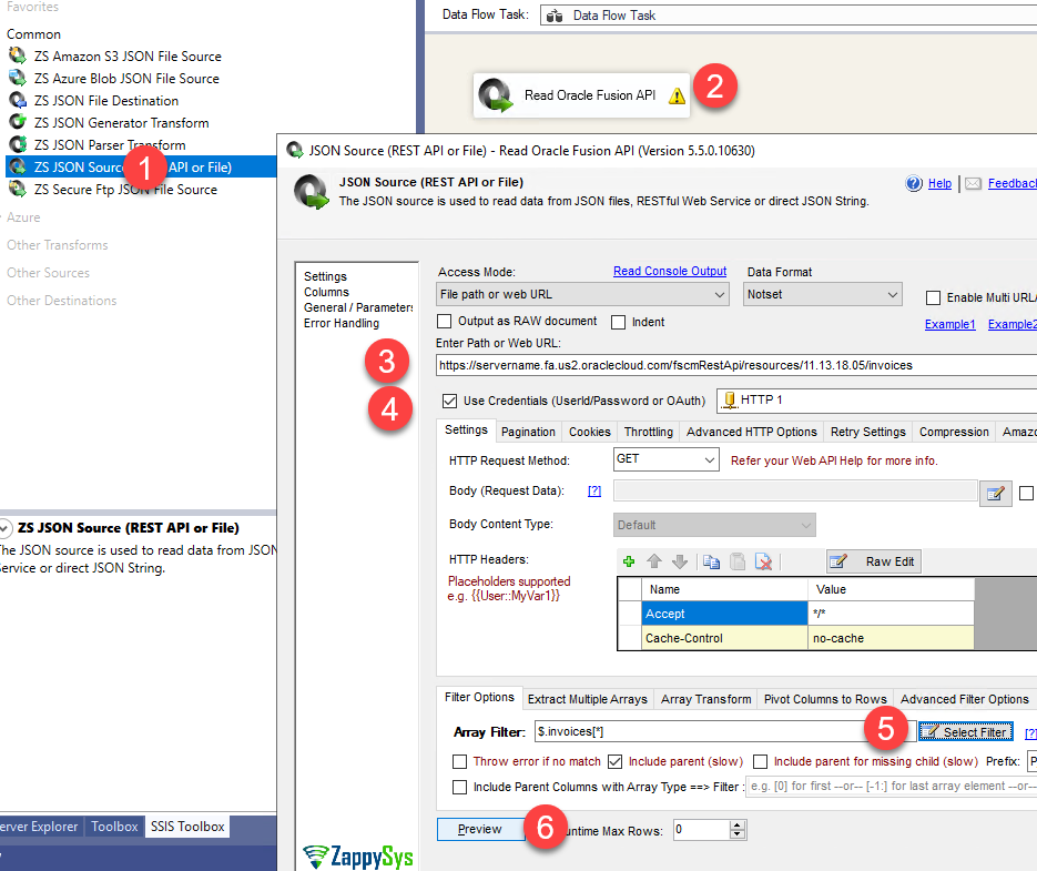

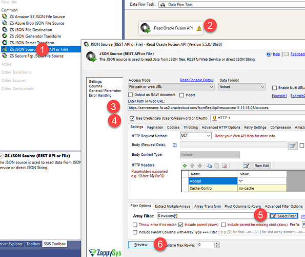

Step 2: Configure JSON Source to Fetch Fusion ERP Data
- Now, Drag and Drop SSIS Data Flow Task from SSIS Toolbox.
- Double click on the DataFlow task to see DataFlow designer surface.
- From the SSIS toolbox drag and drop JSON Source on the dataflow designer surface.
- Double click to edit
- Specify your Oracle Fusion REST API endpoint.
Example:https://servername.fa.us2.oraclecloud.com/fscmRestApi/resources/11.13.18.05/invoices - Check Use Credentials option. From dropdown Select existing connection OR Click new ZS-HTTP connection
- Configure like this
- Select Array Filter (Click Button to use Browse UI). Example for above URL you can pick
$.items[*] - Click Preview to view sample data.

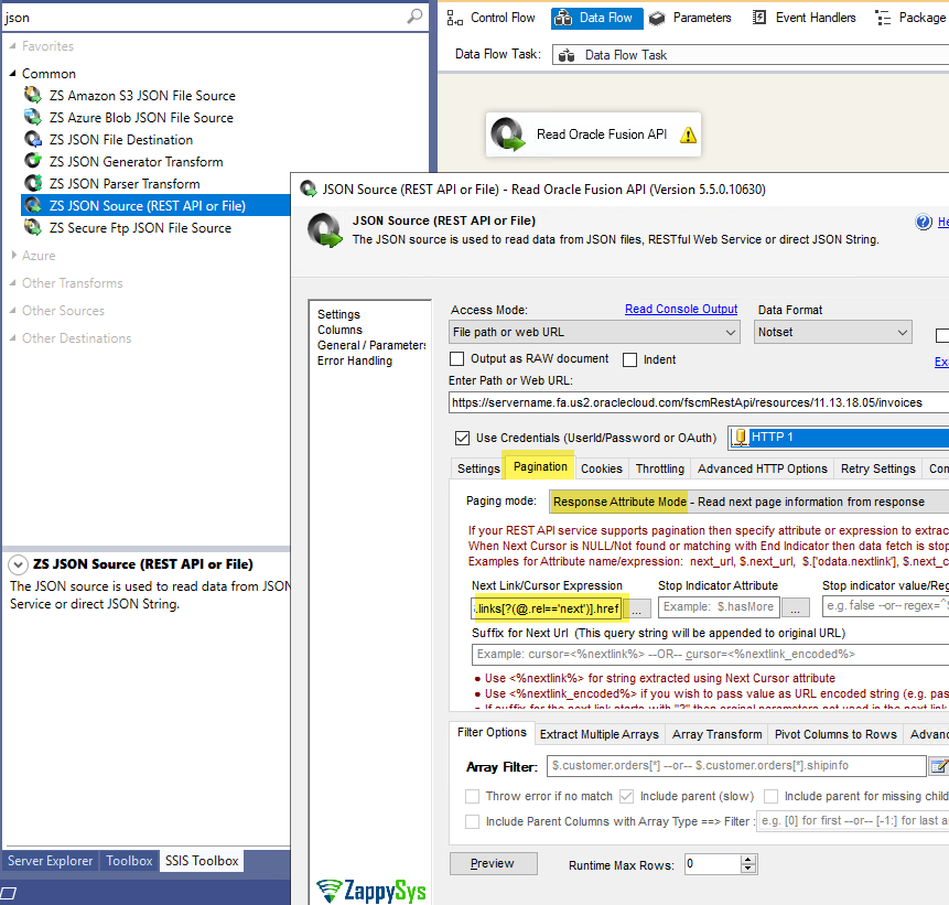

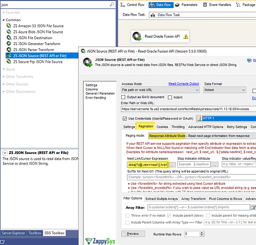

Step 3: Configure Pagination for Oracle Fusion ERP Data
- Go to the Pagination Tab
- Select Pagination using Next Link Attribute
- Enter following Expression in the Next Link/Cursor textbox:
$.links[?(@.rel=='next')].href
