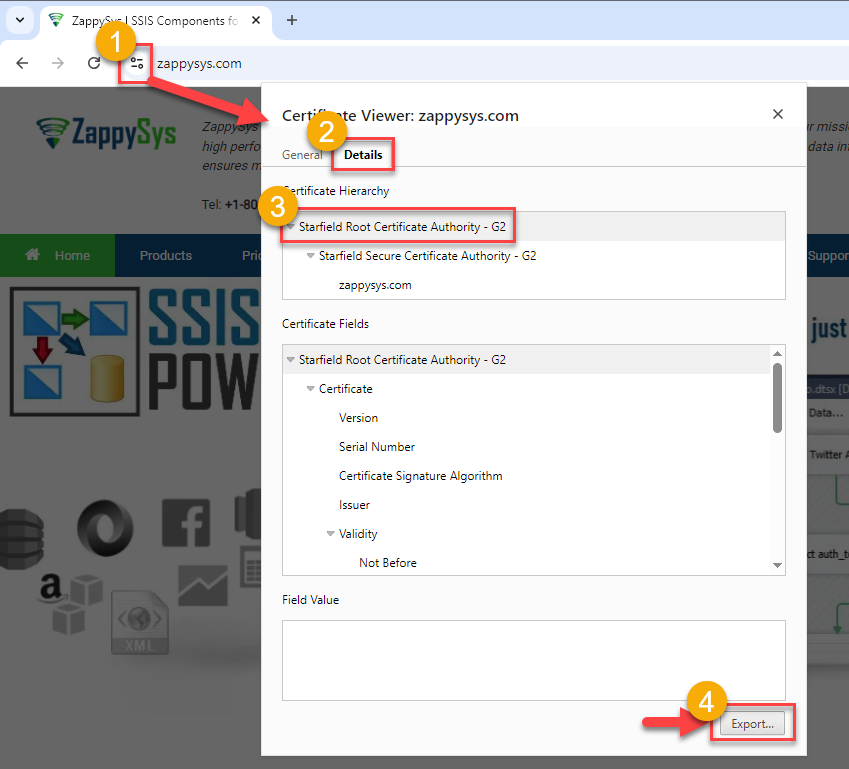

Steps to Export and Install Certificate via Google Chrome / Edge
  1. Open Chrome or Edge and navigate to:
  2. https://zappysys.com
  3. Click the Padlock icon → Connection is secure → Certificate (Valid).
  4. Go to the Certification Path tab.
  5. Select the top-most certificate (Starfield Root Certificate Authority - G2) → click View Certificate.
  6. Go to Details → Copy to File… → export the certificate (.CRT).
  7. Save it e.g. Zappysys.crt

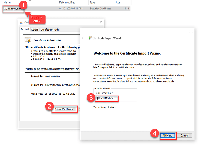

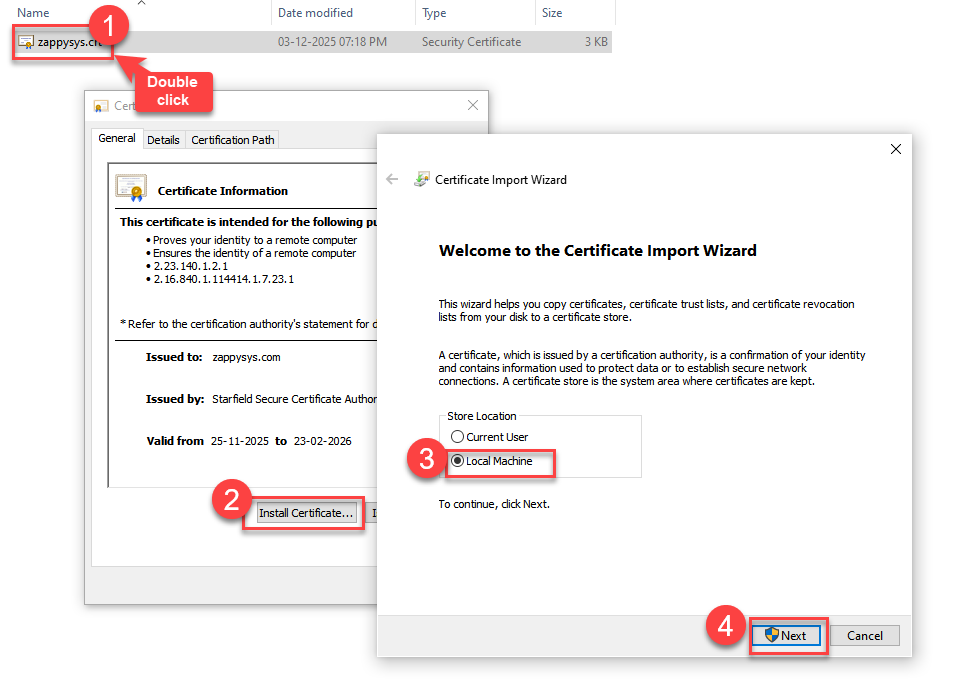

  8. Double-click the exported file → Install Certificate.
  9. Choose Local Machine.
  10. Place it into Trusted Root Certification Authorities.
After completing this, try re-opening the ZappySys License Manager and activating your original ONLINE license key again.

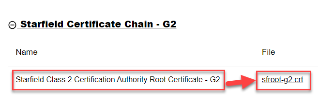

3. Download the Certificates Directly (If Needed)
If exporting through Chrome is not convenient, you may download the required Root and Intermediate CAs directly from the Starfield repository:
Download Links
Download from:
https://certs.starfieldtech.com/repository/
Install Into These Stores
Install each certificate into both:
  • Local Computer → Trusted Root Certification Authorities
  • Local Computer → Intermediate Certification Authorities
This ensures full trust chain validation for HTTPS connections.

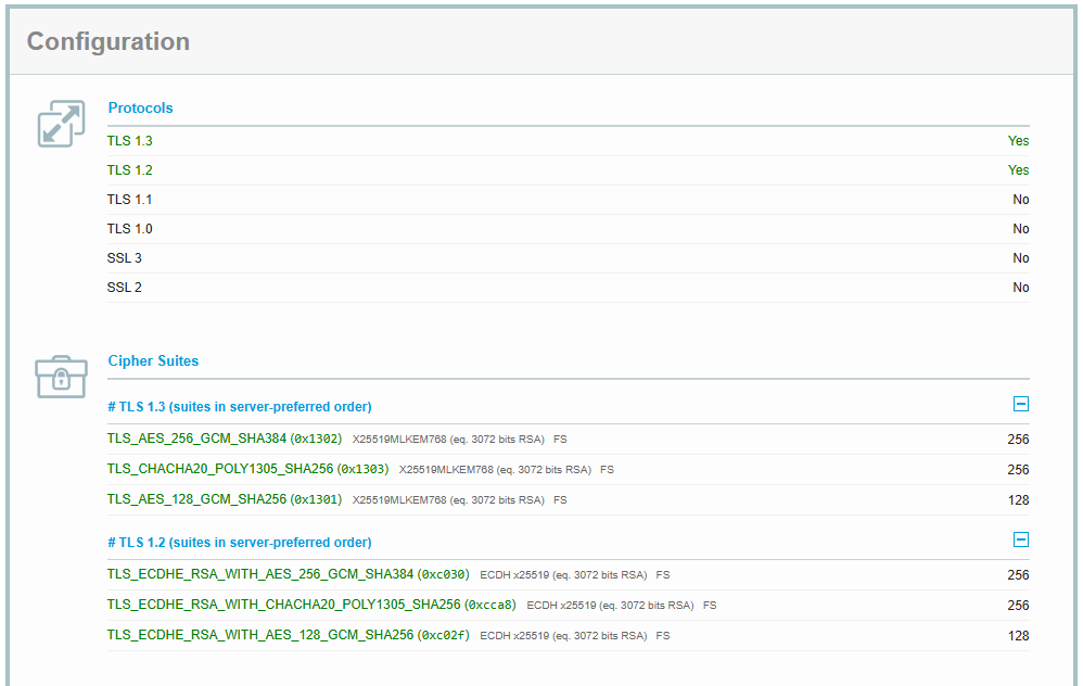

Which TLS Ciphers / Protocols ZappySys Supports
ZappySys servers support modern TLS protocols and strong cipher suites only.
You can review the latest SSL/TLS compatibility report here:
SSL Labs Report for zappysys.com
Supported Protocols
  • TLS 1.2
  • TLS 1.3
Common Supported Cipher Suites
Below are some commonly supported secure cipher suites available on ZappySys servers (subject to periodic security updates).
TLS 1.3
  • TLS_AES_256_GCM_SHA384
  • TLS_AES_128_GCM_SHA256
  • TLS_CHACHA20_POLY1305_SHA256
TLS 1.2
  • ECDHE-RSA-AES256-GCM-SHA384
  • ECDHE-RSA-AES128-GCM-SHA256
  • ECDHE-RSA-CHACHA20-POLY1305
NOTE: Older/insecure protocols such as SSL 3.0, TLS 1.0, and TLS 1.1 are not supported.

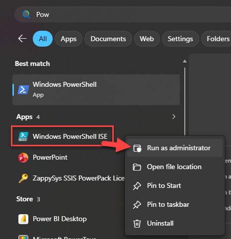

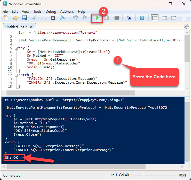

Quick Connectivity Test
Open:
Execute the script below:
$url = "https://zappysys.com/?ping=1"
[Net.ServicePointManager]::SecurityProtocol = [Net.SecurityProtocolType]3072
try {
    $r = [Net.HttpWebRequest]::Create($url)
    $r.Method = "GET"
    $resp = $r.GetResponse()
    "OK: $($resp.StatusCode)"
    $resp.Close()
catch {
    "FAILED: $($_.Exception.Message)"
    "INNER: $($_.Exception.InnerException.Message)"
Expected Result
OK: OK
