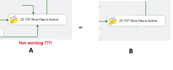

I have pretty complex logic that requires a lot of connections (arrows) and I just found out that if I use setup like in A with multiple incoming flows that box simply doesn’t work.
Tested it thoroughly. Is anybody see the same behavior ? I didn’t see any limitation of how many in arrows (input flows) you can put into FST component.
I’m surely can use dedicated FST box for each flow, but trying to save canvas space .
Or there is some trick (or component) that I can use.

Based on what you’ve shown in the Advanced File System Task (ZS AFST) setup, the behavior you’re seeing is expected.
Why setup A does not work
Although SSIS allows you to visually connect multiple incoming precedence constraints to a task, the ZS Advanced File System Task is designed to execute from a single control-flow entry point.
When multiple arrows are connected directly to the same ZS AFST:

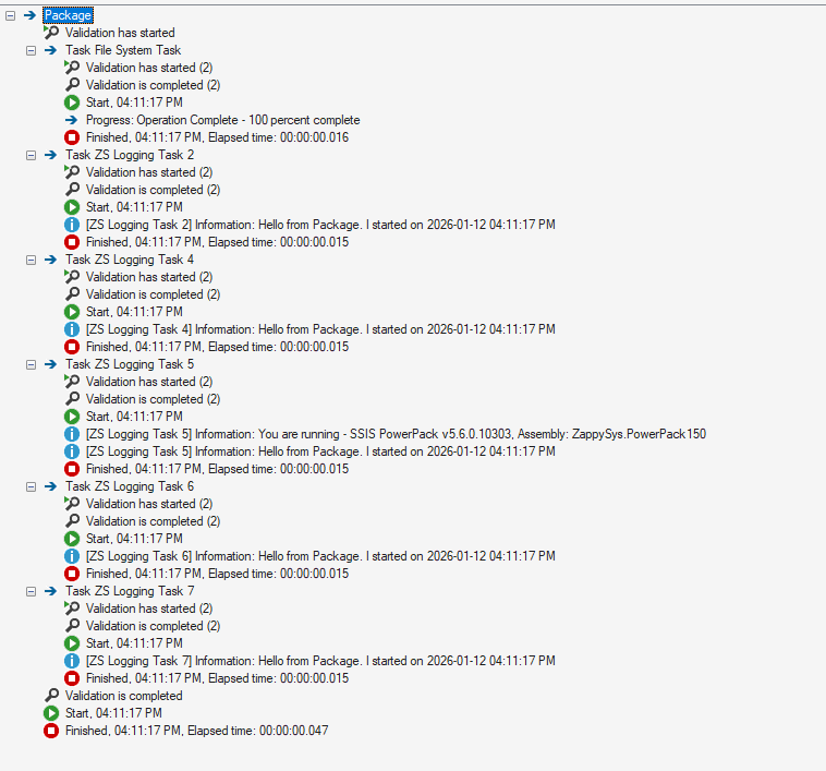

SSIS evaluates all incoming constraints together
By default, this uses AND logic
The task will only execute if all incoming constraints are satisfied in the same execution context
In practice, when those incoming flows originate from different logical paths, the condition is never met. As a result, the task may validate successfully but will not execute the file operation as expected. This is why setup A fails.
In setup B, the ZS AFST has only one incoming precedence constraint, which provides:
A clear execution trigger
Deterministic task execution
Supported and reliable behavior

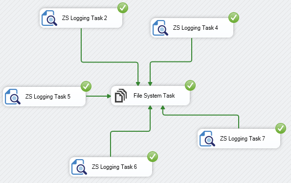

Option 1: Use a Sequence Container (recommended)
If your goal is to reduce canvas clutter while still converging multiple flows:
Point all upstream tasks to a Sequence Container
Connect the Sequence Container to the ZS AFST using a single arrow
This gives you a single execution path into the ZS AFST while preserving your existing logic.
