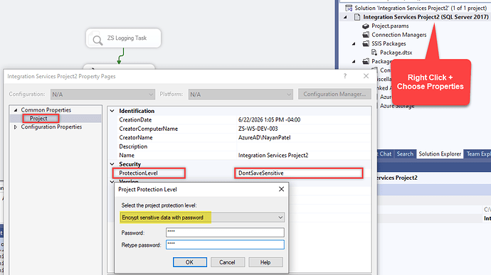

Step 1: Change Project Protection Level
In Visual Studio / SSDT:
  1. Right-click the SSIS project.
  2. Select Properties.
  3. Go to Common Properties > Project.
  4. Set ProtectionLevel to:
EncryptSensitiveWithPassword
  1. Enter the package password.
  2. Save the project.

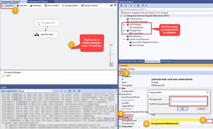

Step 2: Change Each Package Protection Level
Now open each package in the project and update the package-level settings.
  1. Open the .dtsx package.
  2. Right-click on the package designer surface.
  3. Select Properties.
  4. Find the security-related properties.
  5. Set ProtectionLevel to:
  1. Set the same password used at the project level.
  2. Save the package.
  3. Repeat this for every package in the project.
