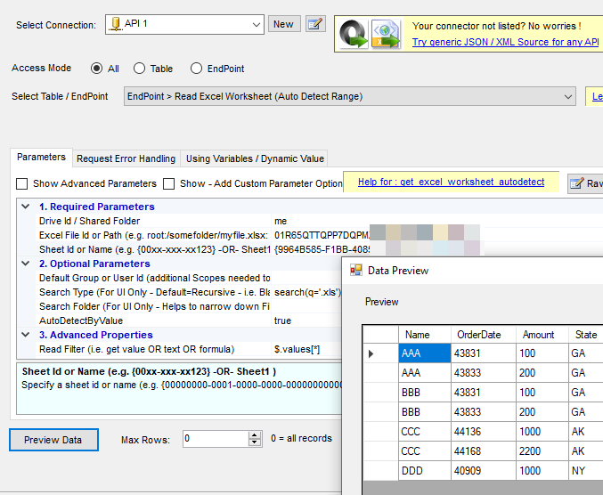

This post will cover one hidden feature of SharePoint Connector / OneDrive Connector. When you read Excel data using Graph API from SharePoint Document Library or OneDrive, the date is returned as a Number (e.g., 43831 rather than 1/3/2020). To fix this issue, perform the steps listed below. You will need the latest connector file.
Without Read Filter change you will below data

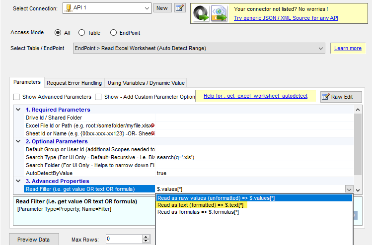

Try to use the latest connector which has a new Read Filter property for Read Excel Worksheet endpoint.

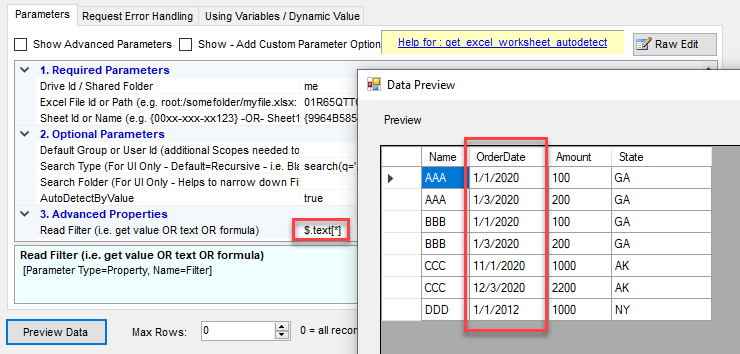

Go to the API source (for SSIS) or API Driver (for ODBC) and change your settings to use Read Filter to $.text[*] as below. This will read all values as text with formatting applied, e.g., $123.50 for currency or 12/31/2025 for date. You must clean or convert to the correct types later on.
After this fix you can see values are with correct formatting
