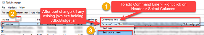

Restart java.exe to reload new settings
If you made changes to JdbcBridge.properties, a very important step is to restart java.exe manually if it’s still using the old port.
  1. Open Windows Task Manager (search “task manager” in start menu)
  2. Go to Details Tab
  3. Sort by name
  4. Find java.exe
  5. Right click and End process tree (NOTE: If you see multiple java.exe and are not sure if it’s the right one launched by ZappySys, then add the Command Line column to confirm. Any command-line invocation of JdbcBridge.jar is launched by ZappySys.
