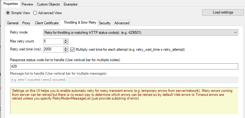

Method 2 — Use the Throttling and Error Retry Tab
If retry options are not shown in the Authentication Parameters, open the connection settings and look for the Throttling and Error Retry tab.
Example:
In this tab, configure retry behavior for specific HTTP response status codes.
For example:
Retry for matching response status code(s): Enabled
Response Status Code(s): 429
Retry Count: 3 to 5
Retry Wait Time: 5000 to 10000 milliseconds
This means the retry waits around 5 to 10 seconds between attempts.
You may also enter multiple status codes if needed:
429|500|502|503|504
Use this when the API sometimes returns temporary failures during large data reads.

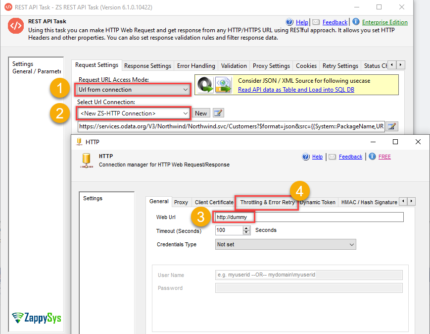

Step-by-Step Setup
  1. Open the SSIS REST API Task.
  2. In Request URL Access Mode, select:
Url from connection
  1. In the Select Url Connection dropdown, choose:
<New ZS-HTTP Connection>
  1. When the new connection dialog opens, enter any dummy URL.
    Example:
https://example.com
This URL can be ignored later if you override the URL directly inside the REST API Task.
5. Go to the Throttling and Error Retry tab.
6. Enable:
  1. Enter one or more HTTP status codes.
    Examples:
429
or:
420|429|500|502|503|504
  1. Set the retry count and retry wait time.

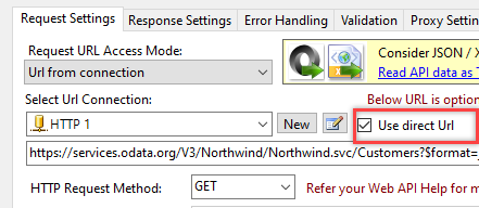

9. Go back to the REST API Task UI.
10. If needed, use the direct URL option in the REST API Task to override the dummy URL from the HTTP connection.

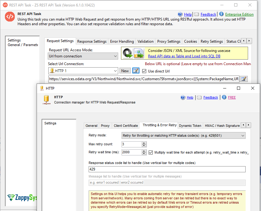

REST API Task Screenshots
REST API Task using a ZS-HTTP connection:
ZappySys HTTP Connection retry settings:
REST API Task URL override when ZS-HTTP connection is used:
