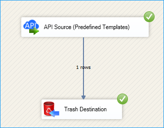

  1. Drag a Data Flow Task to your SSIS package.
  2. Inside the Data Flow, add a ZappySys API Source.

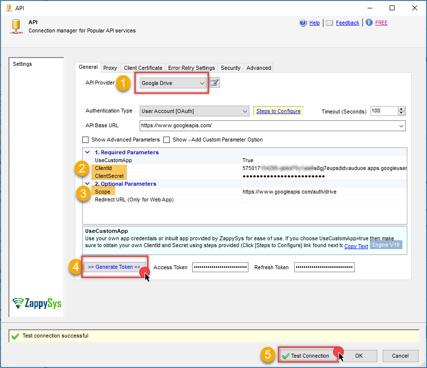

  3. Configure a New API Connection:
    • Select Google Drive Connector
    • Enter Client ID, Client Secret, and required scopes (e.g., https://www.googleapis.com/auth/drive)
  4. Click Generate Token, then Test Connection.
  5. Click OK to save.

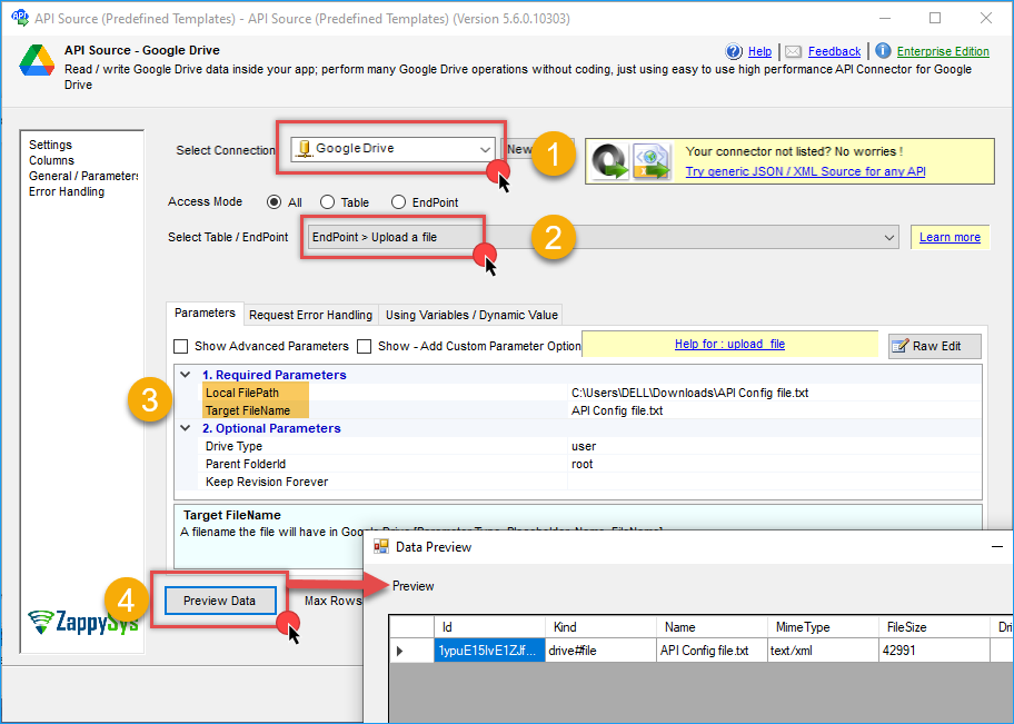

  6. Choose the desired endpoint or Google Drive folder and configure output columns.
  7. Preview the data and press OK to save the configuration.
  8. Drag and drop any destination component and connect to the API source, then run the packs,ge and you will see the result.
