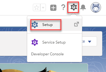

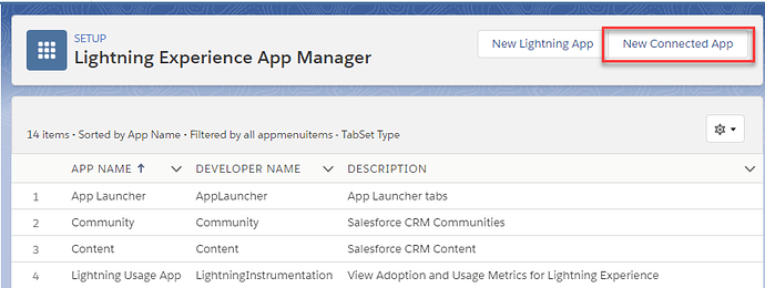

  1. Log in to Salesforce and go to Setup as shown below (click on the gear icon in the top right corner)

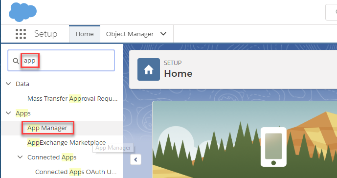

  2. Then in the search bar, input “app” and open App Manager:

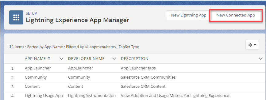

  3. Then click New Connected App to create a new OAuth App
    NOTE: In some versions, it may say New External Client App
Look for one of the following buttons:

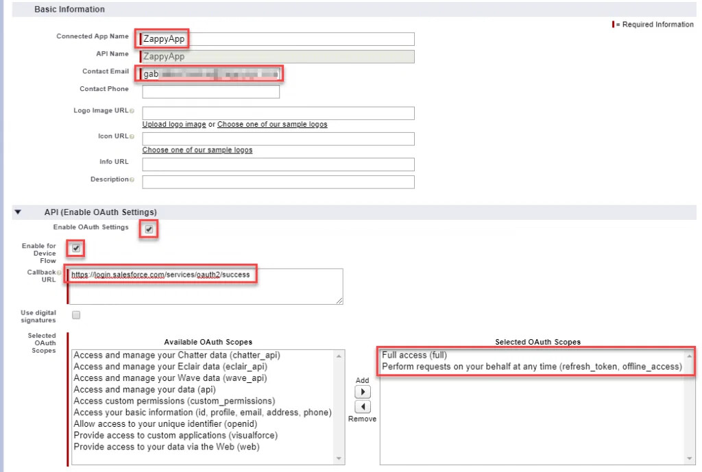

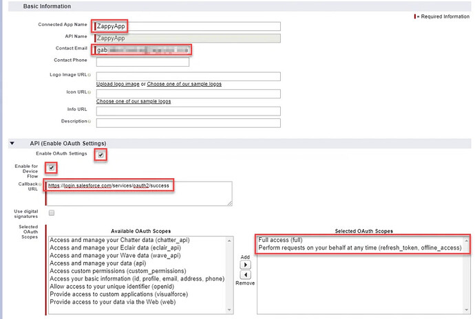

  1. Enter:
  • Connected App Name
  • API Name
  • Contact Email
  1. Enable: Enable OAuth Settings
  2. Enter Callback URL:
    https://zappysys.com/oauth
  3. Select OAuth Scopes:
  • Full access (full)
  • Perform requests on your behalf (refresh_token, offline_access)
  • Access and manage your data (api)
  1. Click Save

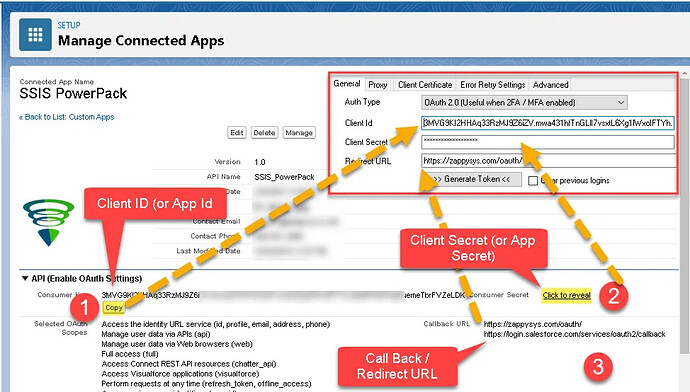

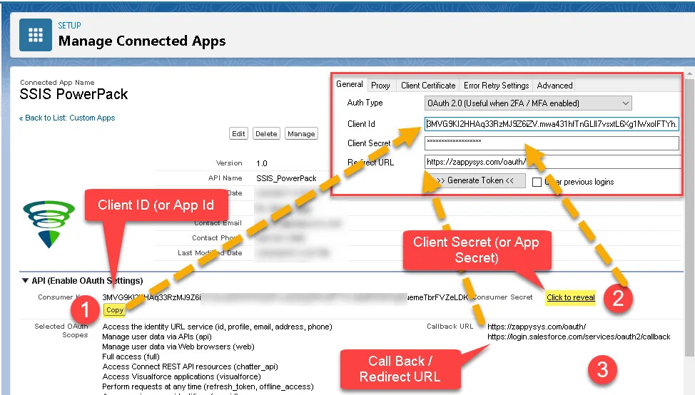

  2. Copy the following values — you will need them in ZappySys:
  • Consumer Key (Client ID)
  • Consumer Secret (Client Secret)

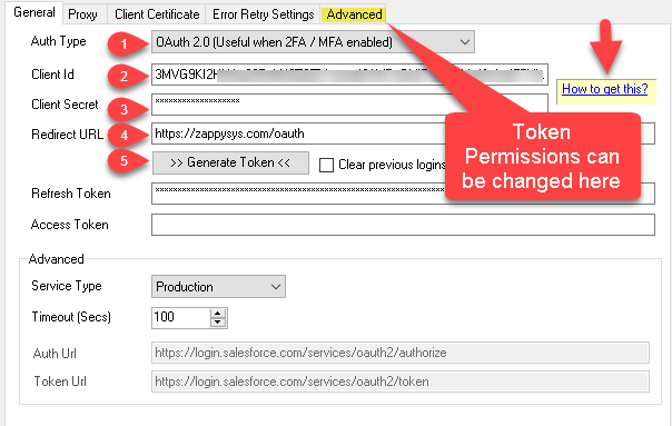

  1. Open your SSIS Package
  2. Edit the Salesforce Connection Manager
  3. Set: Authentication Type = OAuth
  4. Enter:
  • Client ID
  • Client Secret
  1. Click Get New Token
  2. Log in to Salesforce and approve the access request
  3. Save the connection
