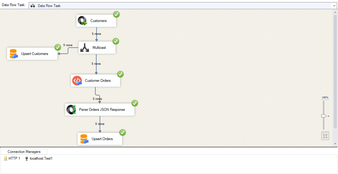

Use this Data Flow pattern:
JSON Source
   +-- optional Multicast --> Save parent customers
Web API Destination
JSON Parser
OLE DB Destination / other destination
The key idea is simple:
Each row coming from the parent API becomes one request to the child API.

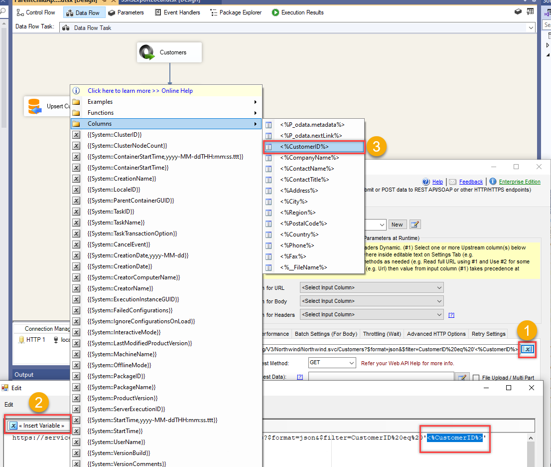

ZappySys Web API Destination can use upstream column values inside the API URL by using column placeholders such as:
<%customer_id%>
So your child API URL can become:
https://mysite.com/api/customers/<%customer_id%>/orders
At runtime, SSIS replaces <%customer_id%> with the value from the current row.

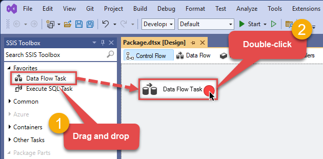

Step 1: Add a Data Flow Task
In your SSIS package, drag a Data Flow Task onto the Control Flow surface.
Open the Data Flow Task. This is where you will build the parent-child API pipeline.

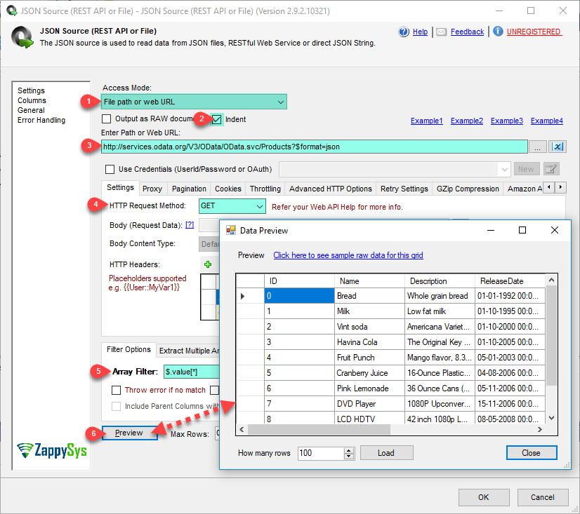

Step 2: Drag JSON Source from the toolbox
From the SSIS toolbox, drag ZappySys JSON Source onto the Data Flow surface.
Configure it to call the parent API, for example:
This source should return one row per customer. Make sure the output includes the parent key column you need later, such as:
customer_id
You can also use another source type if your parent records come from XML, CSV, a database table, or another API source. The important requirement is that the parent key column must be available in the Data Flow output.

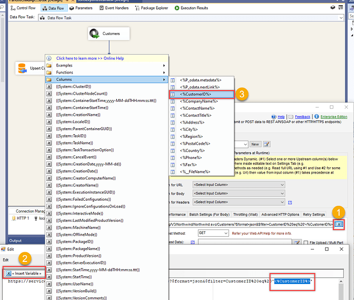

Step 4: Drag Web API Destination from the toolbox
Next, drag ZappySys Web API Destination onto the Data Flow surface.
Connect the parent rows into the Web API Destination.
This component will call the child API once for each incoming parent row.
Configure the request URL using a column placeholder:
Here, <%customer_id%> comes from the upstream JSON Source output. When the pipeline runs, the URL is evaluated row by row.
For example:
https://mysite.com/api/customers/1001/orders
https://mysite.com/api/customers/1002/orders
https://mysite.com/api/customers/1003/orders
This is the part that replaces the manual foreach loop.

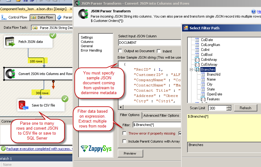

Step 7: Drag JSON Parser from the toolbox
Drag ZappySys JSON Parser onto the Data Flow surface.
Connect Web API Destination to JSON Parser.
In JSON Parser:
  1. Select the raw response column from Web API Destination, such as response_body.
  2. Paste the sample JSON response.
  3. Choose the correct array or object path for the order records.
  4. Preview the output columns.
  5. Click OK to generate parsed columns.
After this step, fields from the child API response become normal SSIS columns, such as:
order_id
order_date
order_total
order_status
If the child API returns an array, set the JSON filter/path to the array node that contains the records you want to output. For example, if the response looks like this:
  "customer_id": 1001,
  "orders": [
      "order_id": 50001,
      "order_date": "2026-01-15",
      "order_total": 125.75
Then the parser path would usually be:
$.orders[*]
If you need the parent columns, such as customer_id, to flow through with the parsed child rows, enable the option to include upstream or parent columns in the JSON Parser output.

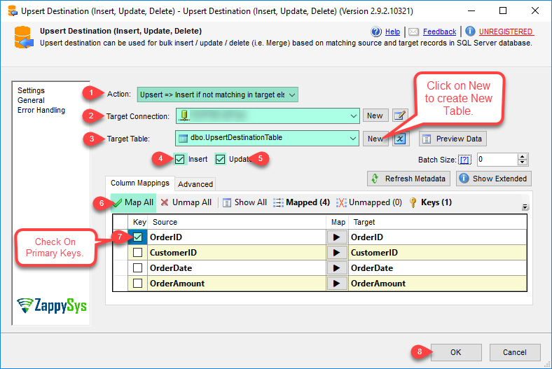

Step 8: Save child records to a destination
Finally, drag your destination component onto the Data Flow surface.
This could be:
OLE DB Destination
SQL Server Destination
Flat File Destination
another API destination
For database loading, ZappySys Upsert Destination is useful when you want to insert new child records and update existing records using a key column.
Connect JSON Parser to the destination and map the parsed child fields to your table columns.
For example:
order_id       -> OrderId
customer_id    -> CustomerId
order_date     -> OrderDate
order_total    -> OrderTotal
order_status   -> OrderStatus
If you need to keep the parent key with each child record, make sure customer_id is passed through the pipeline along with the parsed order columns.
For an upsert pattern, choose the key columns that identify one unique child record. For order data, that is often order_id. If order IDs are only unique inside a customer, use both customer_id and order_id as the matching key.

To call a child REST API for each parent record in SSIS:
  1. Use JSON Source to call the parent API.
  2. Optionally use Multicast to save parent records.
  3. Use Web API Destination to call the child API.
  4. Make the child API URL dynamic using column placeholders.
  5. Use JSON Parser to parse the child API response.
  6. Save the parsed child records to your final destination.
This gives you a clean, visual parent-child REST API extraction pattern without writing a custom foreach loop.
