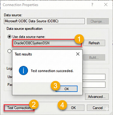

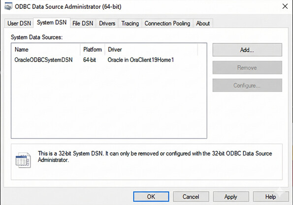

Step 1: Create or Verify the ODBC DSN
- Open ODBC Data Sources (64-bit)
- Create a System DSN
- Test the connection successfully
Important: Always use a System DSN, not a User DSN.

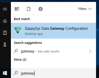

Step 2: Configure ZappySys Data Gateway
Search for
gatewayin Windows Start Menu and open ZappySys Data Gateway Configuration:

- Select your desired ODBC DSN
- Test the Connection
- Finally, click OK
That’s it, the ODBC generic data source is created in the Zappysys Data Gateway

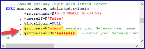

In the generated script scroll down to 4. Attach Gateway login with linked server step, enter your Data Gateway admin username and password.

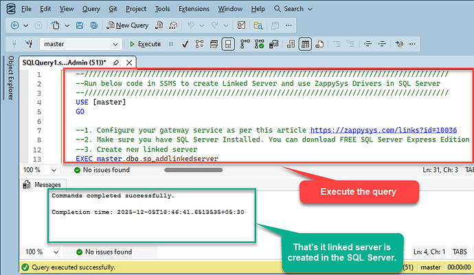

Press Ctrl + A and Ctrl + C to copy the entire script.
Paste the script into SQL Server Management Studio (SSMS) and run it.
That’s it, the linked server is created in the SQL Server.
