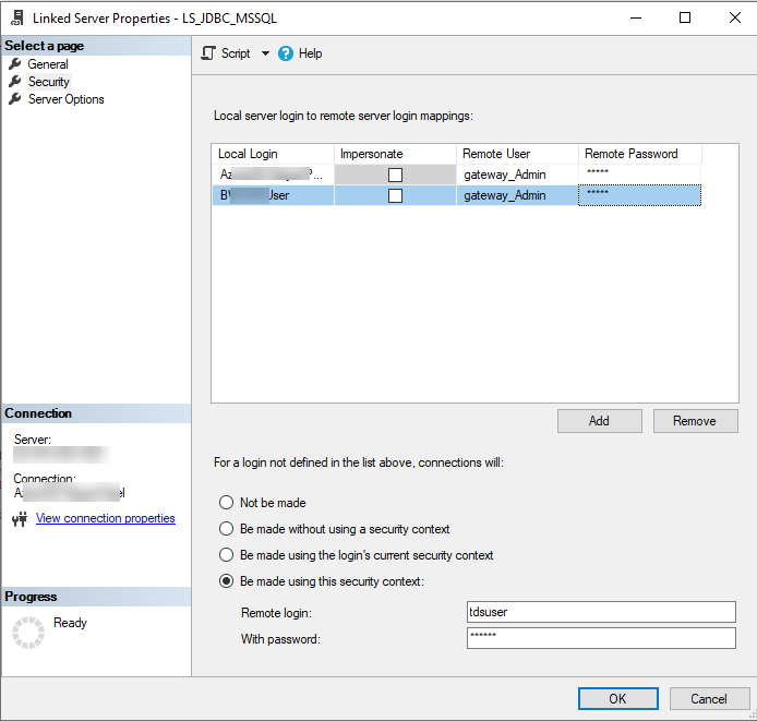

Using the SQL Server Management Studio (SSMS) Interface
If you prefer using the graphical interface instead of running scripts, you can configure these mappings directly in the Linked Server properties:
  1. In Object Explorer, expand Server Objects > Linked Servers.
  2. Right-click your ZappySys Linked Server and select Properties.
  3. Go to the Security tab.
  4. For Specific Users: Click Add in the top section to map individual local logins to the gateway_Admin remote user.
  5. For Global Access: In the bottom section, select “Be made using this security context” and enter your ZappySys Gateway credentials. This acts as a fallback for any user not explicitly listed in the top grid.
