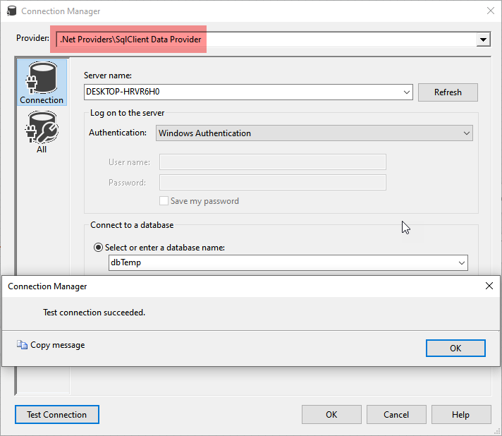

Change the SQL Server Connection Manager to use:
SqlClient Data Provider
After switching the provider, the Upsert Destination is able to acquire the SQL connection successfully, and the package executes without errors.
Open your SSIS package.
Edit the SQL Server Connection Manager used by the Upsert Destination.
Locate the .NET Provider setting.
Change the provider from:
Microsoft SqlClient Data Providerto:
SqlClient Data Provider -
Save the package and execute it again.

After changing the provider:
- Source component continues to retrieve data successfully.
- Upsert Destination validates successfully.
- Data is inserted/updated in SQL Server without errors.
