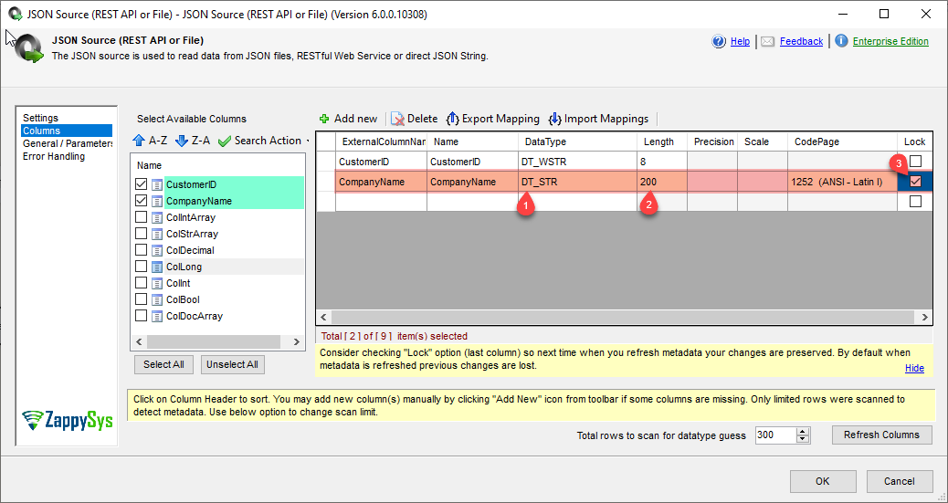

Solution 1 - Change the Data Type in the ZappySys Source (Recommended)
This is usually the easiest solution because the conversion happens directly inside the ZappySys component.
  1. Open your ZappySys Source.
  2. Navigate to the Columns tab.
  3. Locate the affected column.
  4. Change the data type from
DT_WSTR
to
DT_STR
  1. Specify the appropriate length.
  2. Click OK.
  3. Enable Lock.
  4. Execute the package again.
Why this works
Changing the datatype inside the source ensures that every downstream component receives the correct datatype, eliminating the need for additional SSIS transformations.
Tip
If your data contains only English or ASCII characters, DT_STR is usually sufficient.
If your data contains multilingual characters (Chinese, Japanese, Arabic, emojis, etc.), you should continue using Unicode (DT_WSTR) whenever possible.

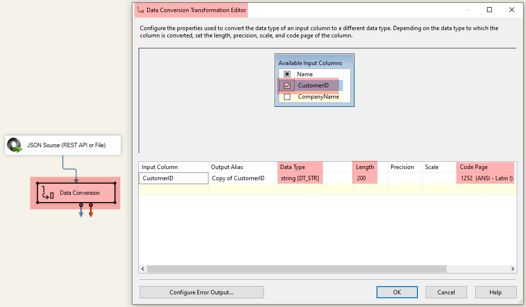

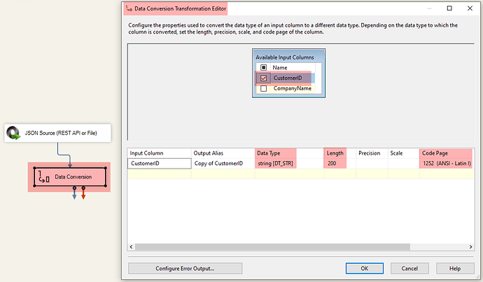

Solution 2 - Use the SSIS Data Conversion Transformation
If you don’t want to modify the source component, use the built-in SSIS Data Conversion transformation.
  1. Drag a Data Conversion transformation into the Data Flow.
  2. Connect the ZappySys Source to the Data Conversion component.
  3. Select the Unicode column.
  4. Change the output datatype to:
DT_STR
  1. Choose the correct Code Page (typically 1252 for Western characters).
  2. Map the converted column to the destination.
Advantages
  • No changes required in the source component.
  • Keeps the original Unicode column available.
  • Easy to identify converted columns.
This is Microsoft’s standard approach for converting Unicode to Non-Unicode values in SSIS.
